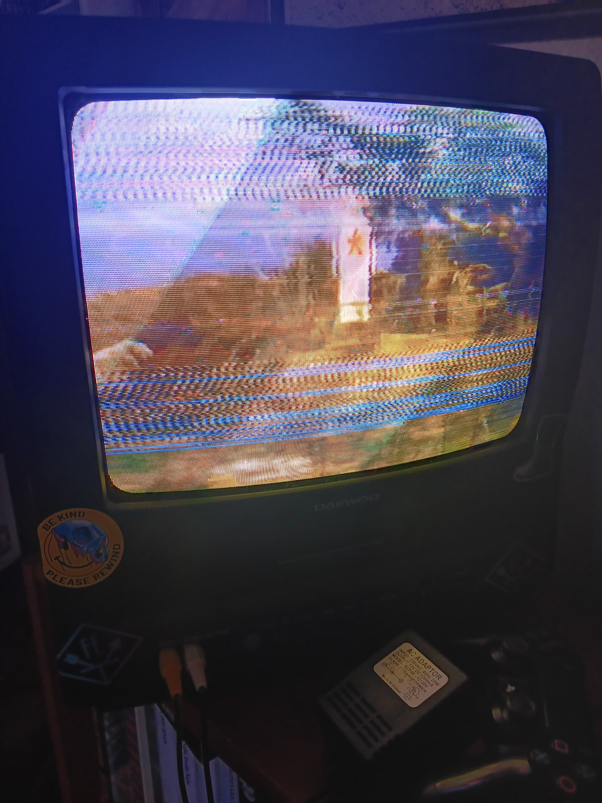

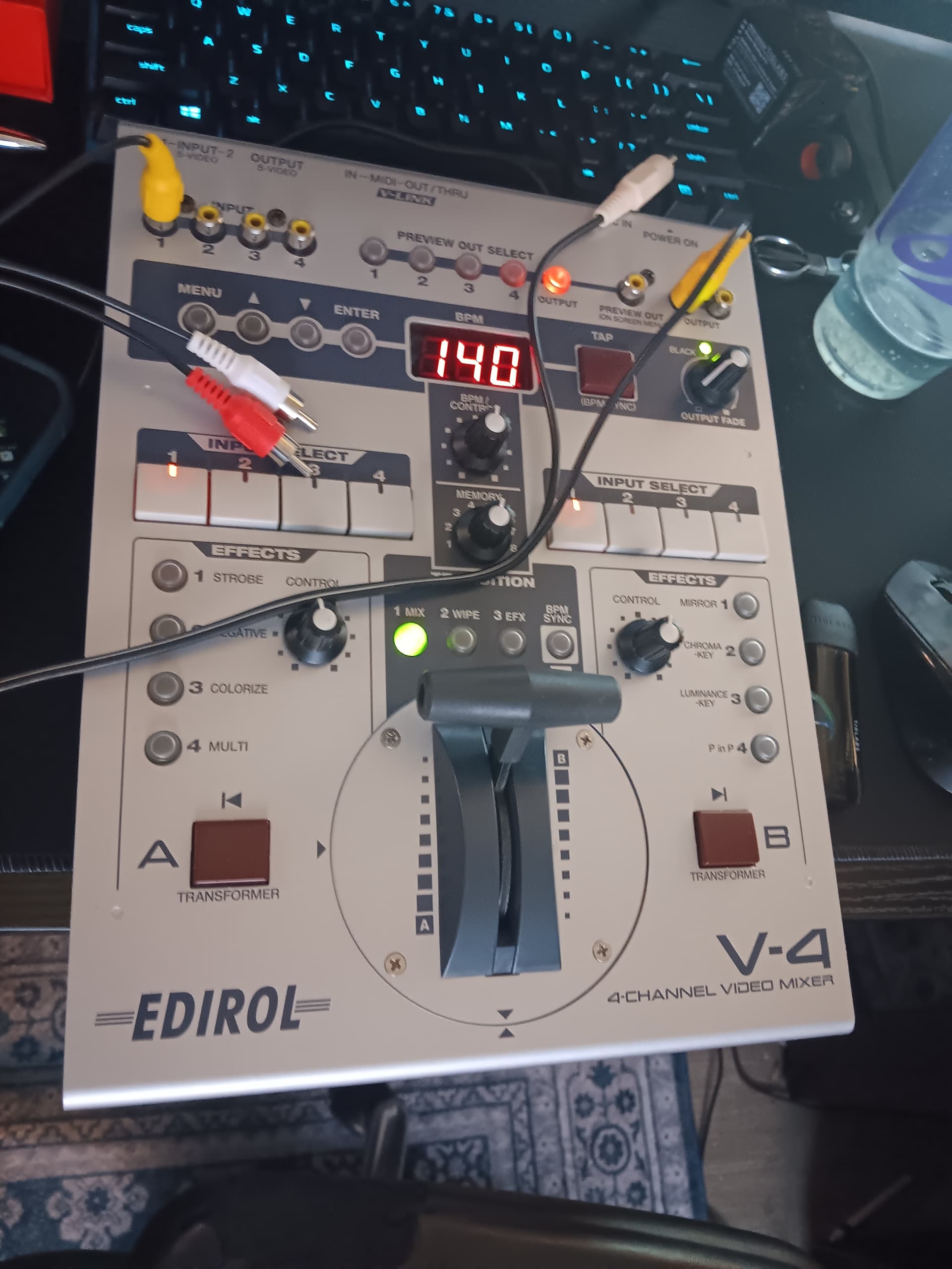

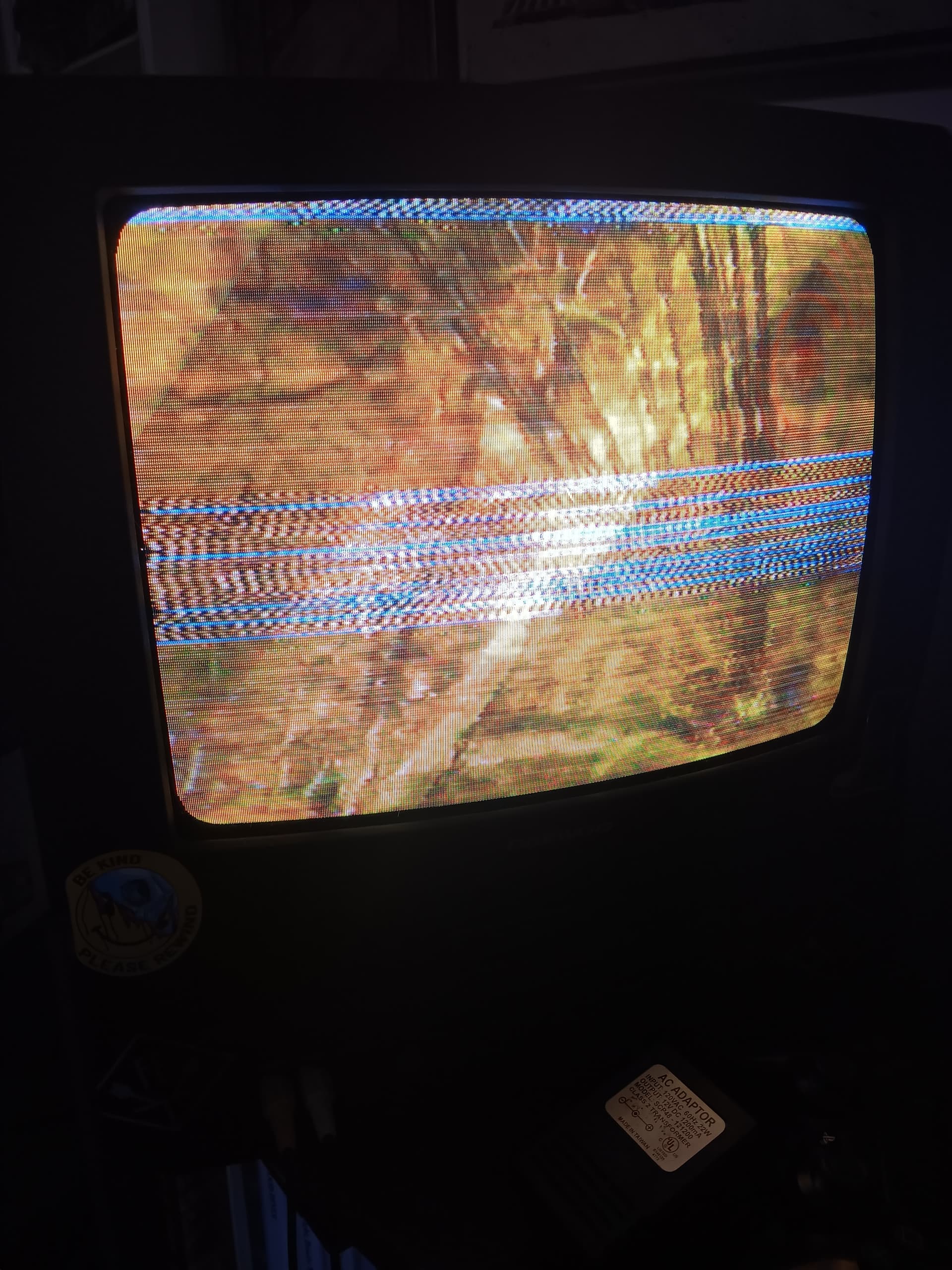

Im having some trouble with a v4 i recently purchased. I get horizontal static lines that scroll up the image. The ebay seller says it looks like interference but ive tried 2 other v4s with my setup and never had any issues so i am a little skeptical thats the issue. I have exhauseted all cord and input issues and nothing has fixed the issue. Id really rather not return the unit so any help is greatly appreciated.

this is a ground loop, edirol gear is notorious for this, try a ground loop isolator in yr signal chain
i agree with trying a ground loop isolator, but whatever you try, keep in touch with the seller as you go so there is a conversation history documented if the troubleshooting is unsuccessful and you eventually need to get a refund.
Yeah, it was the first thing i did. Also tried new rca cables, and a new power supply.
Any recommendations on a good one? I purchased one that said it was for audio as I didnt see one for video but then i found one but it utilizes coax and grabbed that too.
audio seems like a crapshoot. search for ‘video ground loop isolator’ on ebay/amazon/alixpress and you will find what you need. most every one i’ve seen has bnc connectors.
