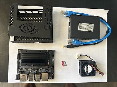

As I was searching for alternatives, I found this-
Will this work for a second GW as a backup? If so, I may DIY a second unit.
