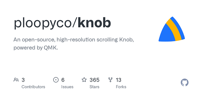

the simplest and most DIY friendly project for arbitrary resolution controller might be working with a QMK controller

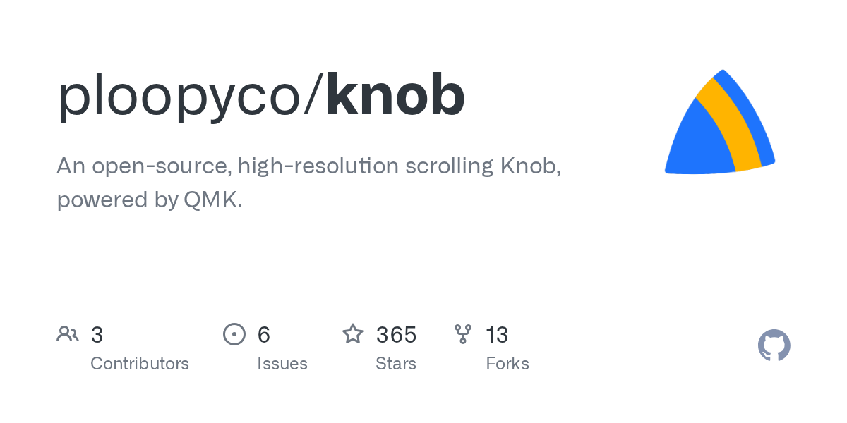

heres a very simple example of a single stand alone knob made by the incomparably named ploopyco
working with QMK stuffs is like fairly accessible for beginners if you don’t need to edit anything, becomes slightly more complex at whatever point you need to start customizing things.
