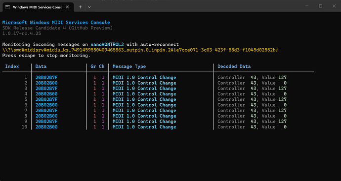

I thought it might have been a Windows 11 issue, but I tried on a Windows 10 pc and still have the same issue. I tried numerous different versions of WPDSK but no luck. I thought the midi controller might have been defective but Windows midi reporting shows that all the inputs are working correctly and being received by the OS. Just recently I went as far as grabbing a RPI 3B and loading an image of VSERPI Waaave Pool, and the NK2 works perfectly on that system, so it’s not the midi controller, and it’s not the config file.

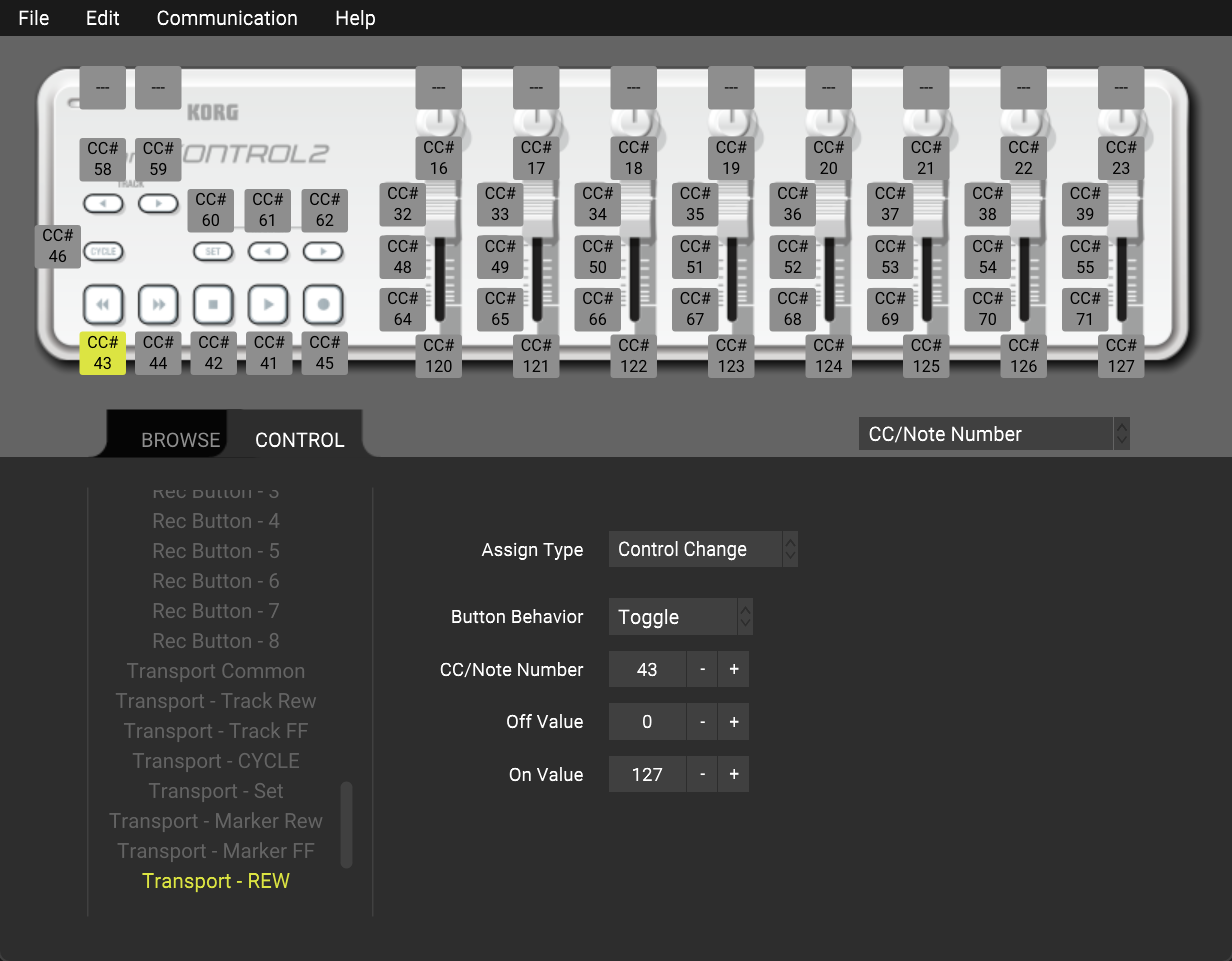

[edited] to include a couple screenshots of the midi monitoring and korg kontrol editor config in case i’m missing something
as per the midi documentation in WPDSK, the buttons aren’t mapped to anything. so if all the sliders and knobs work then everything is working fine!
if folks want like full midi mapping built in for buttons and stuff, significantly more support on patreon and/or the current WPDSKPRO kickstarter would result in lots more freeware in general as well as more work done on improving midi and other interface fuctionality in the freeware. as things stand rn, the original WPDSK will not get any further updates, in favor of WPDSK Pro free editions it will be fully open sourced after the WPDSK pro kickstarter finishes up tho so someone may eventually create a distro with exact midi specs
Oh I see. I guess the mappings for A-N in the manual are just for the rpi version?
the documentation for wpdsk midi (and everything else) is all in contained the app itself!
