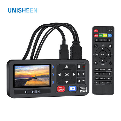

Hi @Sahasra, you can always capture the full output from the Roland with one of this. I use the RCA version of the device and works fine even capturing a two hours session. I also use it as a portable tiny preview screen. This way you wont’ collapse the RPi with processing and capturing at the same time.
i agree that a dedicated capture box can be nice like @xose mentioned. i personally use a computer but i don’t love that all the time so sometimes i borrow a recorder.

Thank you! very interesting. After a bit of digging, I found another one called EZCAP 776 that seems to also capture video. Could be useful when I don’t have a laptop nearby.

The website only had an inquiry memo box. Can these be purchased anywhere else?
Seems like they’re available on alixpress:
Sorry for that. There’s exactly where I purchased my UR230A. Videos on my channel are all recorded whith it out of a V4 at minimum 4mb/s bitrate and upscaled on the same device then posted with no edit. Just for you to check the not sooo good but for me, acceptable quality for 90€
