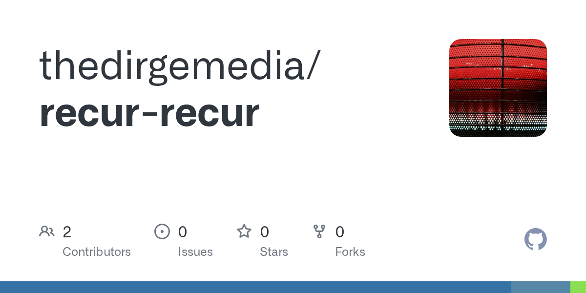

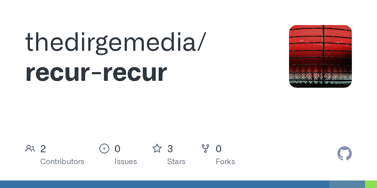

Recur-recur. cyberboy666 recur - ish for pi 5
https://github.com/thedirgemedia/recur-recur
pi 5 implementation based on recur
best to think of it as inspired by rather than ported, a work in progress but fully functional
if you have a pi5, screen and the numeric keyboard floating around, give it a spin, also takes live video from pi camera. also midi (mostly untested apart from shader and parameter changes)
