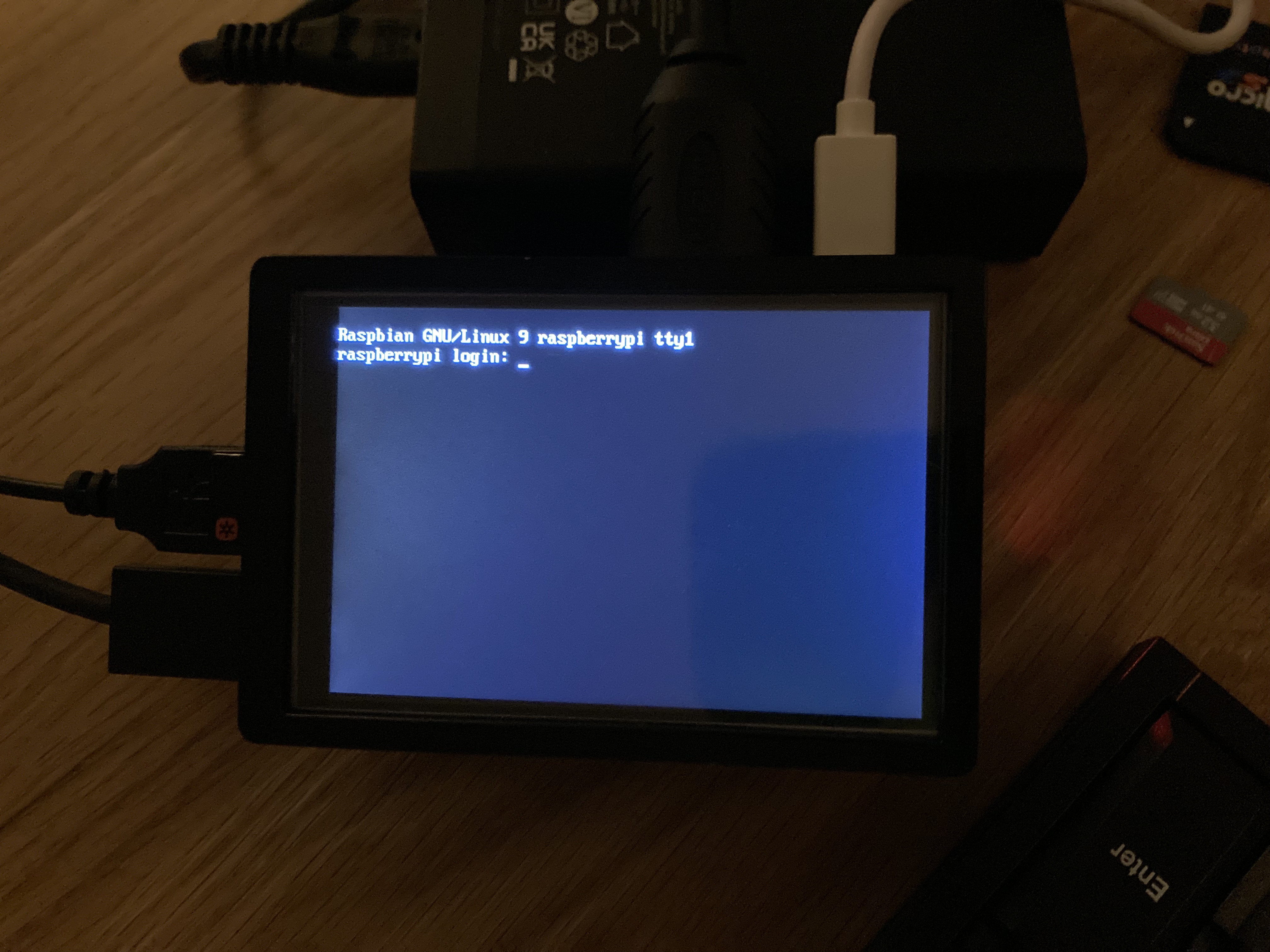

  1. On V2_1 - RasPi asks for a password then I get a blank screen after 5 seconds or so.

Hello jamieoxford. I am a beginner with first experiences with wavepool. I am interested in your project. I think the only point I can give you a hint is to point one. I had the same login issue. The problem was nothing about a login. The reason was I use a weak power supply. Hope that helps. Greetings from here

  1. I’ve since successfully booted V2_1 on my Pi - it just took a long time to start up. (I assume the default ‘raspberry’ password would work here though)
