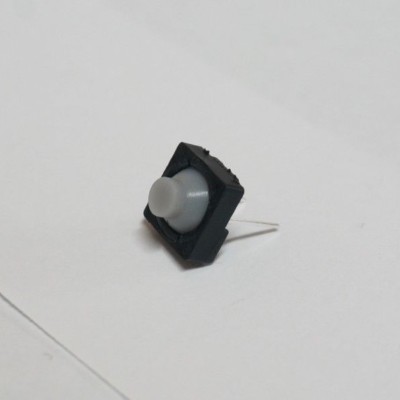

Hi, does anyone have recommendations for a suitable replacement tact switch part for the larger Edirol V4 buttons (transformer, input select, etc)? It’s part number 00125590, a “soft tact” switch, as opposed to the smaller push buttons.
A company in Australia sells packs of a replacement part but I’m in the US.

Can you measure the physical footprint of the switch itself? I’m seeing a few different physical sizes…
Thanks! I’ll measure this week when I open it back up, the other buttons I ordered just came in :slight_smile:

I was thinking to give these a shot, they seem like they’d be about the right size but not sure:
https://aretronics.com/products/soft-touch-tactile-pushbutton-spst

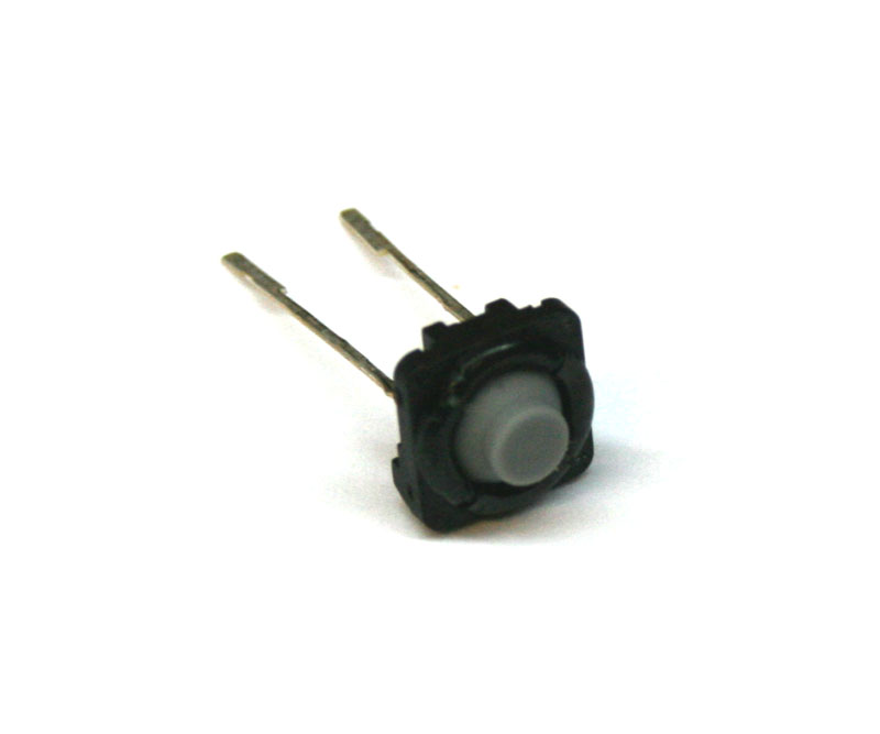

The listing below actually matches the part number per the repair manual (00125590), but doesn’t ship to the US.
Also, it’s 17 of them, haha. If other people need them and live somewhere they ship to, maybe we could work out some mail..
I saw this, such a cool page.
Yep, the soft action ones are what I need. I already sourced some of the hard push buttons. From what I can tell, this part was used also on Roland 505s.
Actually, I think these are the real deal.
Id be down to mail some to folks who need them. I only need 3, anyone want to add some?
