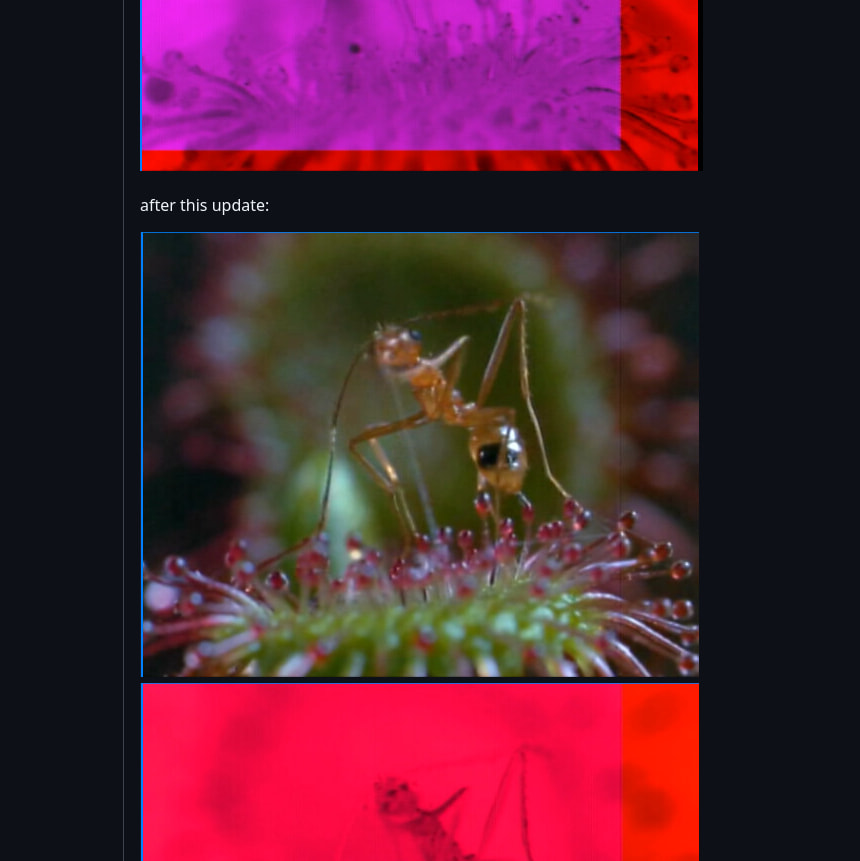

its true - we attempted to solve this chroma shifting issue with a previous sync_ope revision a few yrs ago (more info on it [here]( Release minor fix to improve colour shift / level difference between send and return · cyberboy666/sync_ope · GitHub )
and the results with the capture card i was using was quite good:
however it has since been reported by some people that they are still getting quite large offsets with the updated circuit (like i assume @stacysworld is using)
