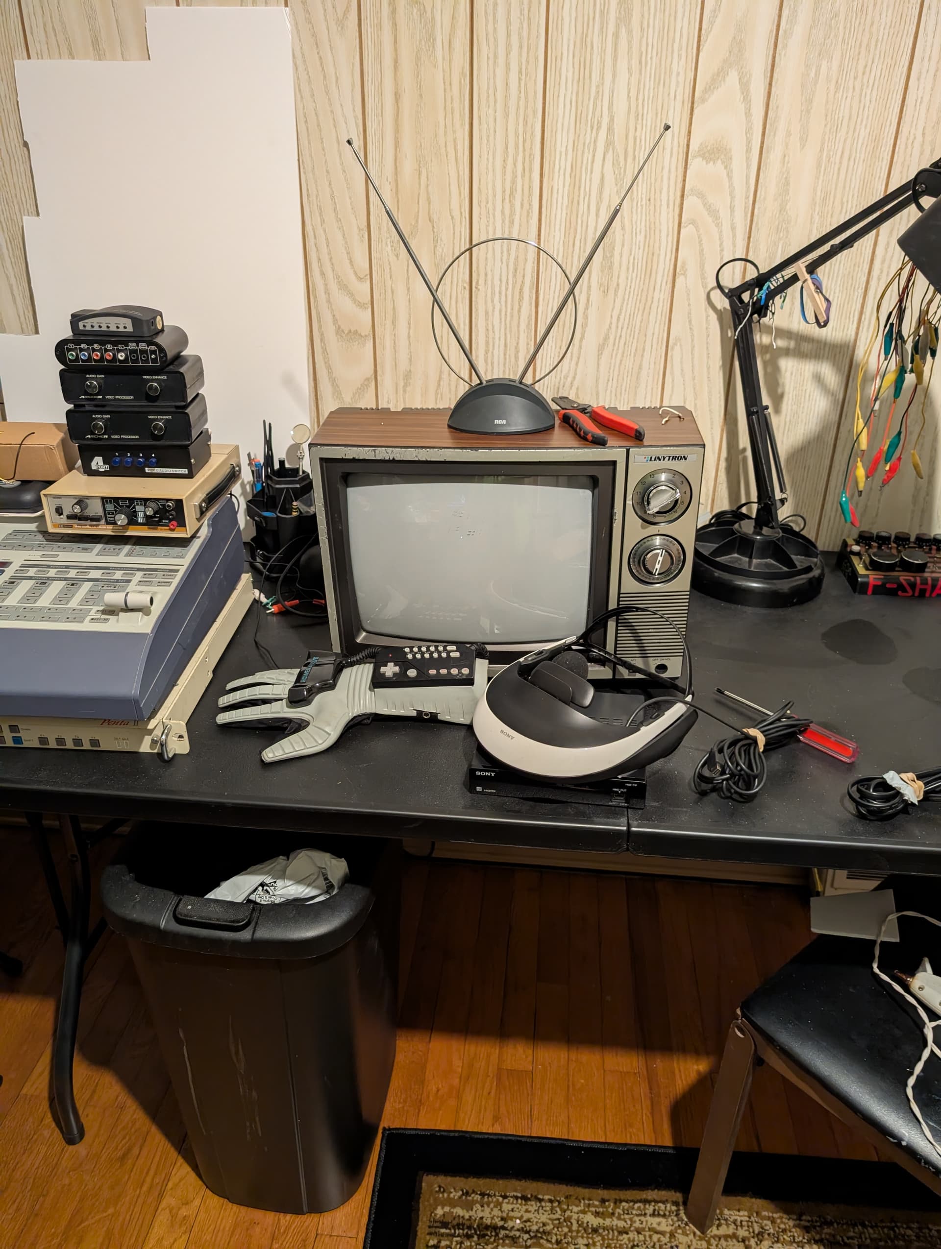

I need to be able to see so the hidden camera will constantly be fed to a first gen Sony 3D headset.
I need an easy way to operate the rig so i’ll be managing all the screen output through resolume and to control Resolume/VSERPI I will be turning a NES Powerglove into a MIDI controller assigning the buttons to scene selection and the finger resistors to VSERPI parameters. For further parameter manipulation I will be outfitting the glove with a 3 axis MPU-6050 accelerometer.
To communicate with people I don’t want to break character and just start speaking aloud. To solve this I want to use a throat conduction mic in conjunction with speech to text software that will overlay on top of whatever’s playing on the screen. This should allow me to whisper and have whatever I say be displayed on the screen. Of course I’ll make it print out like it’s a glitched out early terminal. ^-^

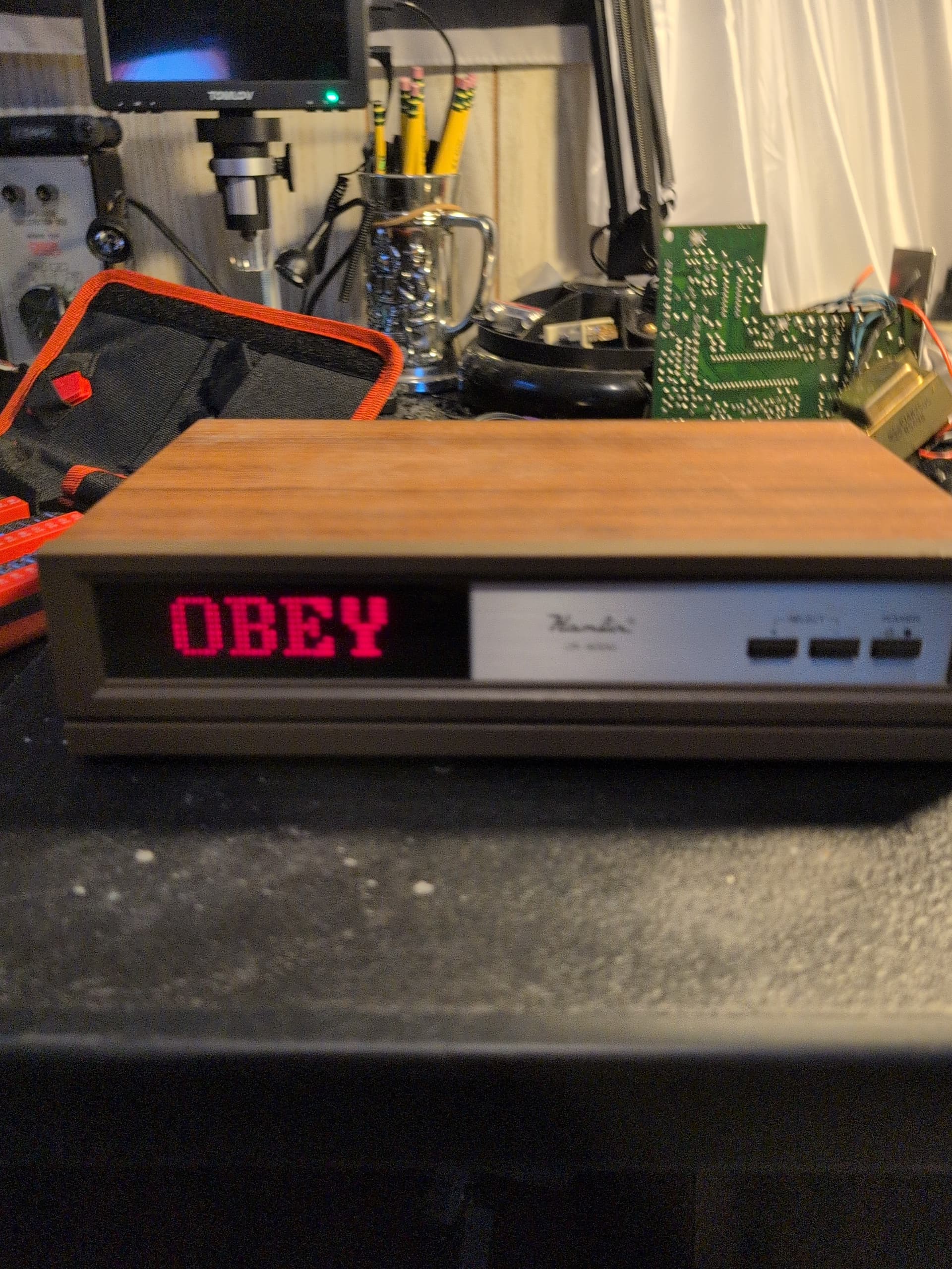

To fix this I introduce my solution:
This beautiful cable box should supply enough room for most of those things listed. Of course the standard segmented display just wouldn’t cut it so I slapped in a led matrix display.
