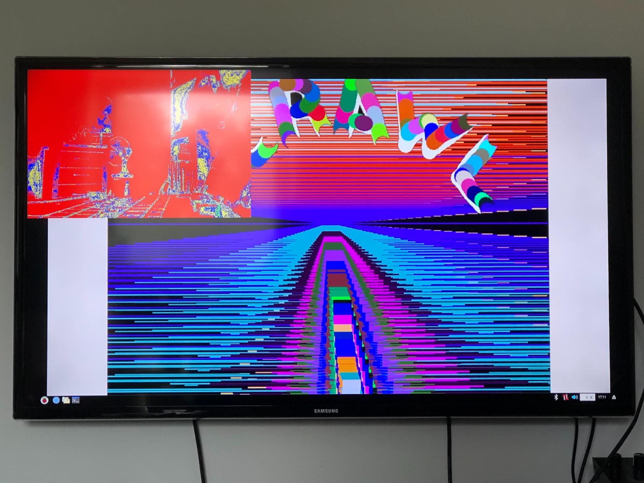

Hi Andrej, here is a picture. I must correct my message. I dont mean the video feed i mean the video output. I try many steps to get the resolution bigger but it didn’t work. As i go back to version 3.5 the problems was solved.
regards Manfred
looks like you are running the openframeworks code instead of working directly from the image file, or you have modified the stock image to increase output resolution (and change the desktop background). you’ll have to edit the code directly if you want it to fill the screen, however that will result in fps dropping to truely undesirable levels.
You could add the following line to the waaave pool src/main.cpp after settings.setSize(720,480);:
settings.windowMode=OF_GAME_MODE;
Then, in a terminal, if you run make Release in the main project folder - /home/pi/openFrameworks/apps/myApps/waaave_pool/ (I’m doing this from memory so it might not be quite right) - type make Release and wait for five minutes. Once it’s built you should have an app that sets the desktop resolution of the host OS to the resolution of the app - 720x480.
