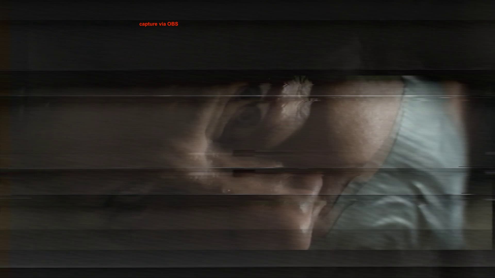

I am monitoring the signal via the HDMI of the Intensity Pro 4K and I can see all the nice glitch artefacts etc. However when capturing the composite signal with the BM Declink it all disappears.
I tried to take the HDMI monitor signal into the Blackmagic Duo 2 via a Blackmagic HDMI to SDI but gives the same result. Scanlines are replaced by ugly gradients, sharpness is gone the refresh rate of the monitor is also 60Hz which gives a very nice effect. When capturing the composite it does a pulldown to 25fps…

I am getting a slightly better result when I capture via OBS but it still only runs at 25fps.

Capture via OBS

OBS can capture with scanlines but is limited to 25fps.
