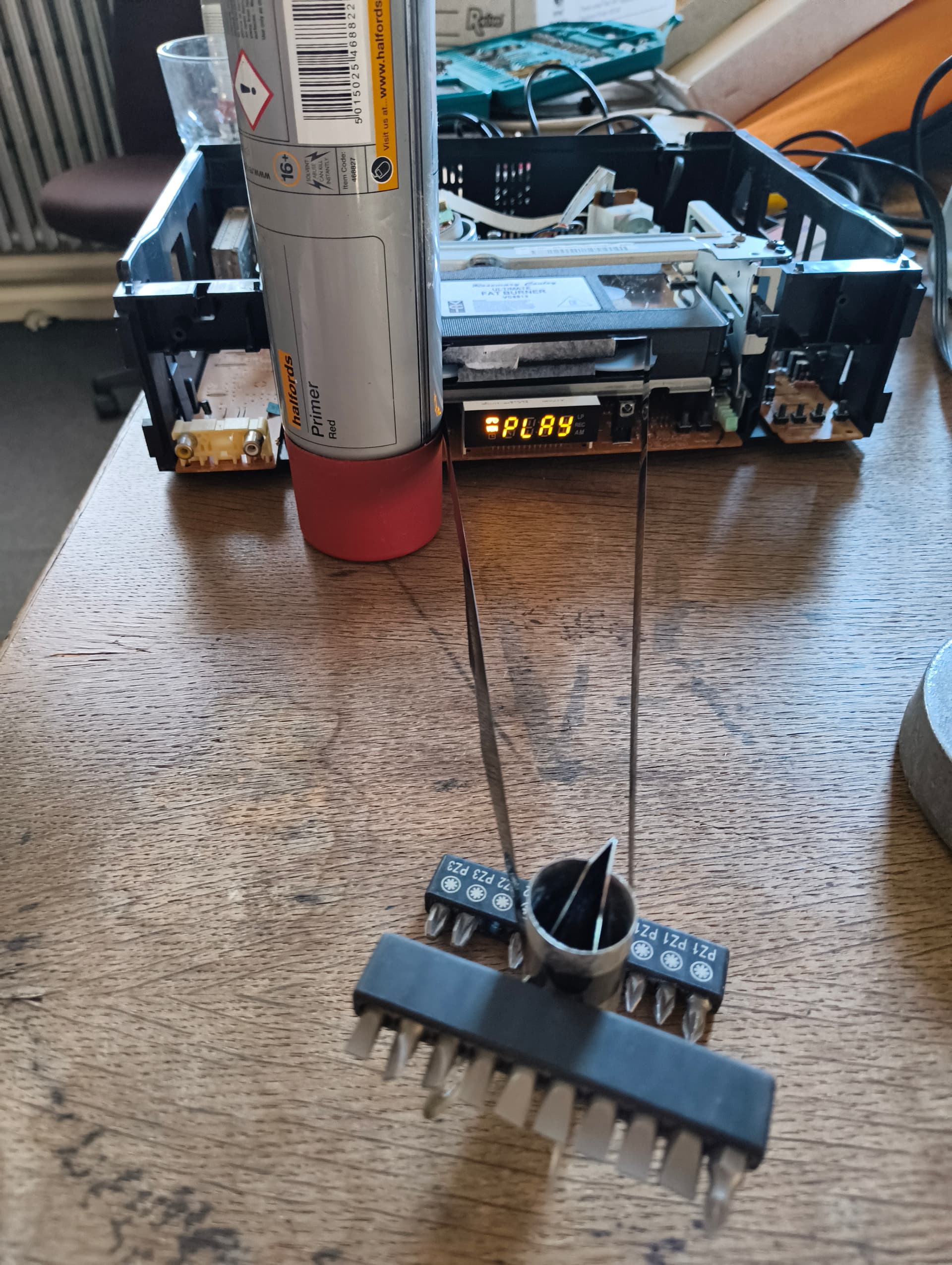

Well I’ve made my first very basic loop, just one VCR and a pre-recorded tape.
I feel like pins with spools from inside a VHS tape would be enough to physically guide the tapes between the two decks. Then some way to adjust them precisely or perhaps springs tensioning them…
Beyond that I’m thinking about a spooling system like the Vocu tape delay has, but on both record and play sides to offer some mechanical separation between the two VCRs so they aren’t pulling on each other directly.
Here is a video of a test loop with 1 VCR it shows how temprapemental the system is.

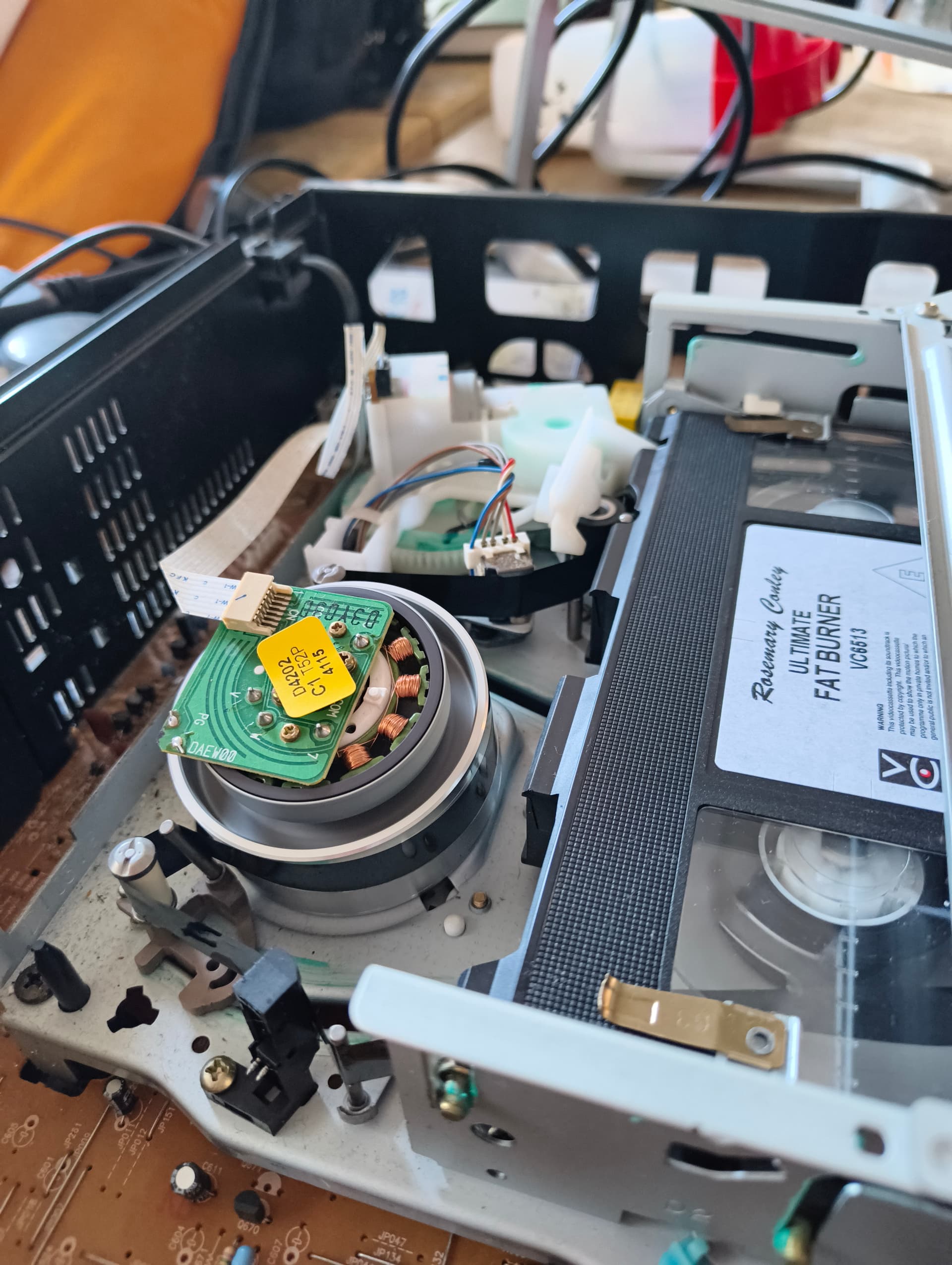

Ooh. Fun experiment! Looks like a good model vcr for accessing the tape.
If you take out the head assembly, you’ll still need the electronics that spin the head drum. Alignment (enough to get a usable signal) would probably be very difficult as well. Surely fewer headaches to find a second deck of the same model and have them face each other.
I really like the idea of stripping down the PCB more and exploring the possibilities of detached read heads.

Further learning: cut away more of the back of the VHS tape than you expect, almost right to the screws that hold it together. Longer loops come out at much shallower angles. Or Carefully position a spray can.
Also there’s a minimum extra length required because the tape is pulled out a long way to be played. I’m going to see if it’s at all possible to create a loop inside a tape case.
Keep in mind that the amount of tape pulled out by a VCR to line it up on the head is not a constant. Different models will pull different amounts of tape out, making an all-in-the-shell tape loop an engineering ride through hell.

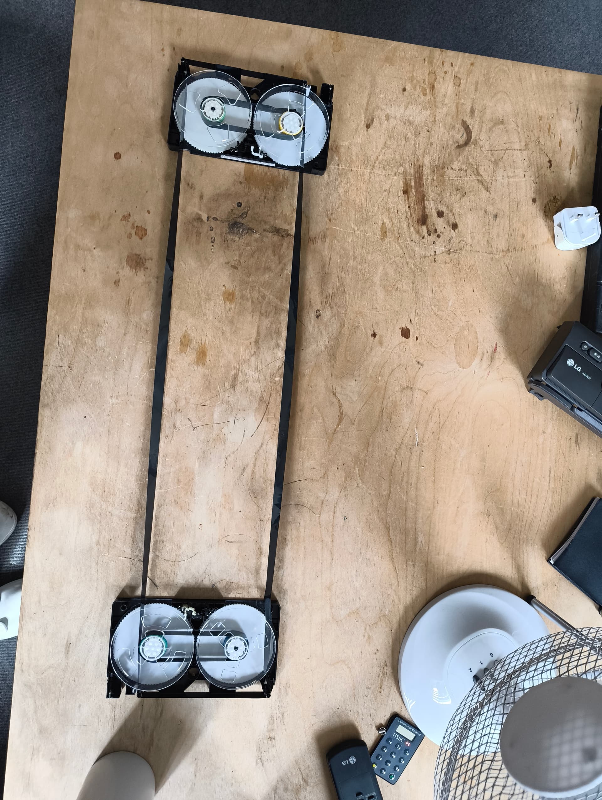

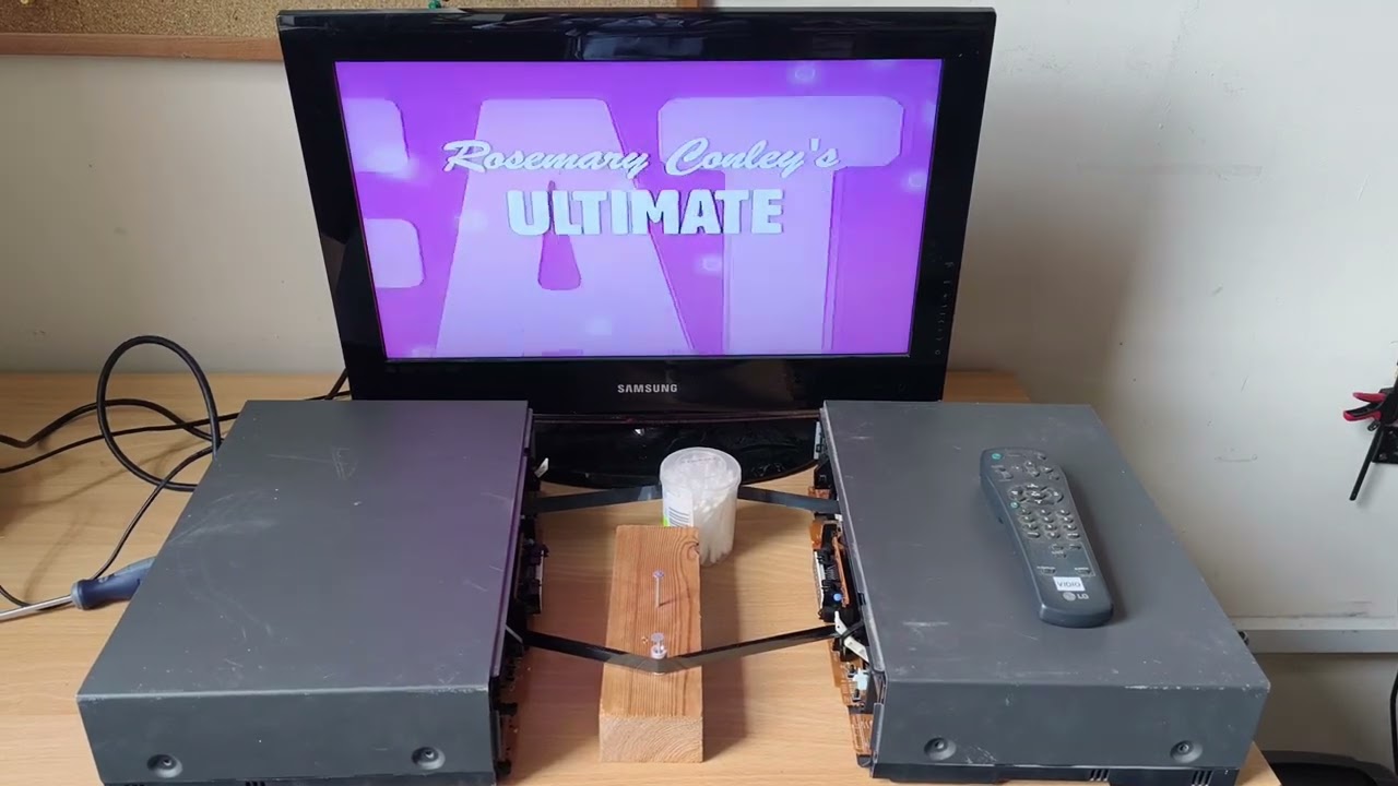

First milestone surpassed: a 2 VCR VHS tape loop.
Need a second scart capable monitor to test how playback looks on both VCRs at the same time.
My innovation: elastic bands wrapped round each spool and then a mini loop of VHS tape that only goes around the spools so the VCR is happy with the internal tension of the VHS tape and the loop can be played indefinitely.
These are identical VCRs and can be started simultaneously with one remote control.
I want to get better at splicing the VHS tape, maybe buying a jig as it’s a real faff to match and tape the cuts.

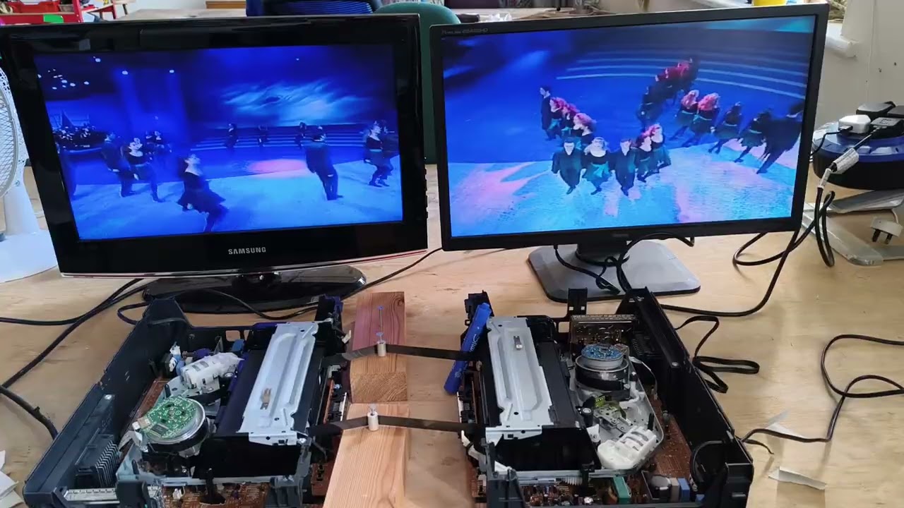

The next step worked, two VCRs & two screens.
Roughly 110cm VHS loop, very delicate adjustments on the path of the tape, the marker being the final addition which got the tension across both VCRs just right.
