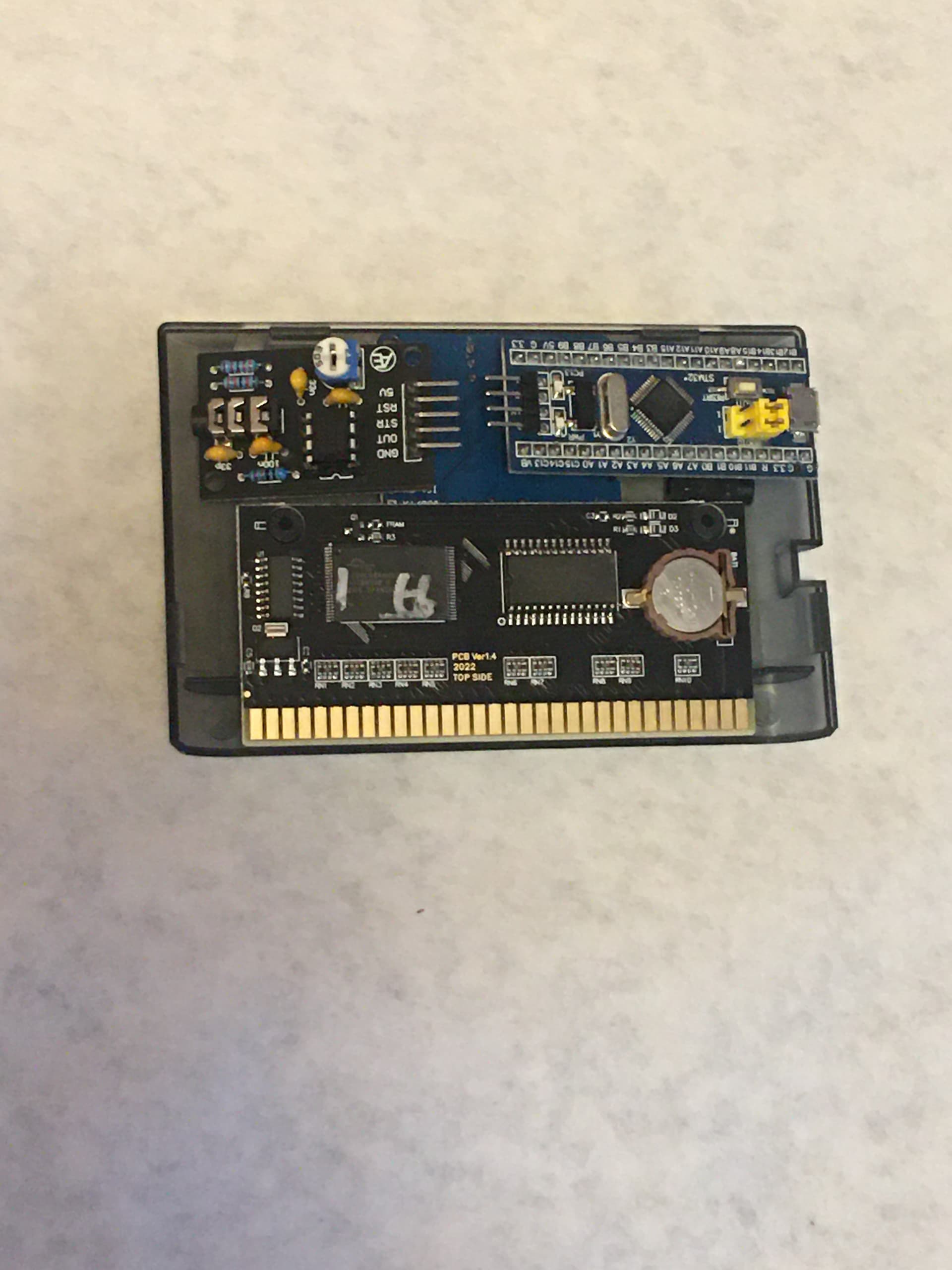

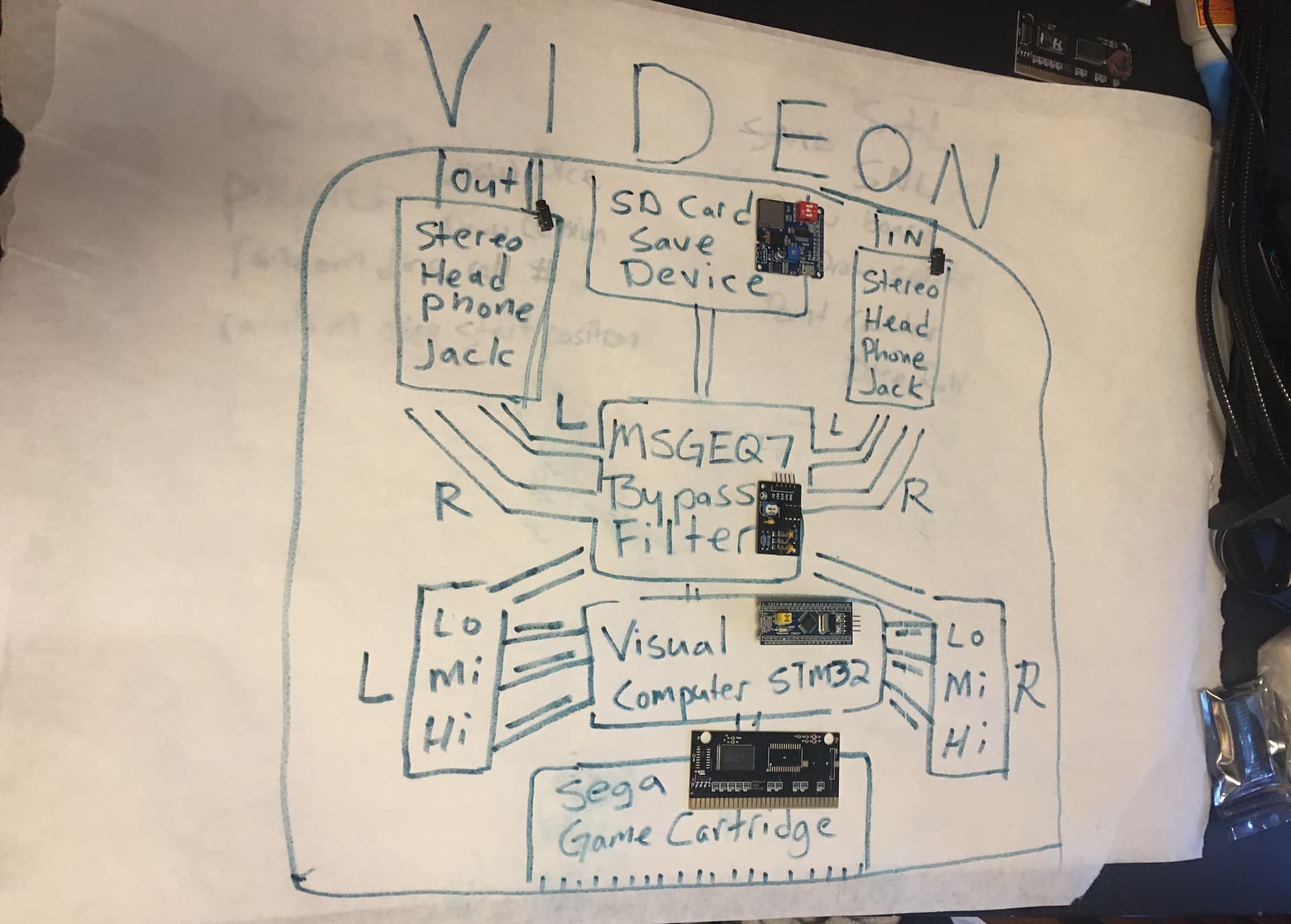

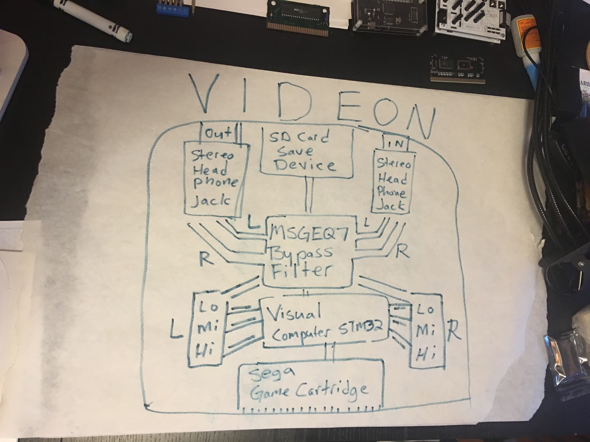

I’ve been working with the Sega Genesis lately. Realizing that it has a 68000 I thought it was a little computer. Had an idea to turn it into a audio reactive visual synthesizer. Going to make it open source and create a how to build PDF. Calling it VIDEON cause like Video - on … Videon. Hoping to write 100 different Visual patches. All of which would be Audio Reactive and you would use the Sega Controller to adjust the Visual parameters.
You would plug audio into the cartridge using an Aux cable, the stereo audio would be divided into two channels running through the MSGEQ7 chip which would also divide both left and right channels into Low, Middle and High frequencies the STM32 would take that data and create visuals using the data and the Sega Genesis 68000 CPU. Oh and it has an Audio Out so you can plug your music back into speakers. Also hoping to add an SD card port so people can make their own Visual patches.
Once done hope to make a Super Videon for the SNES.
